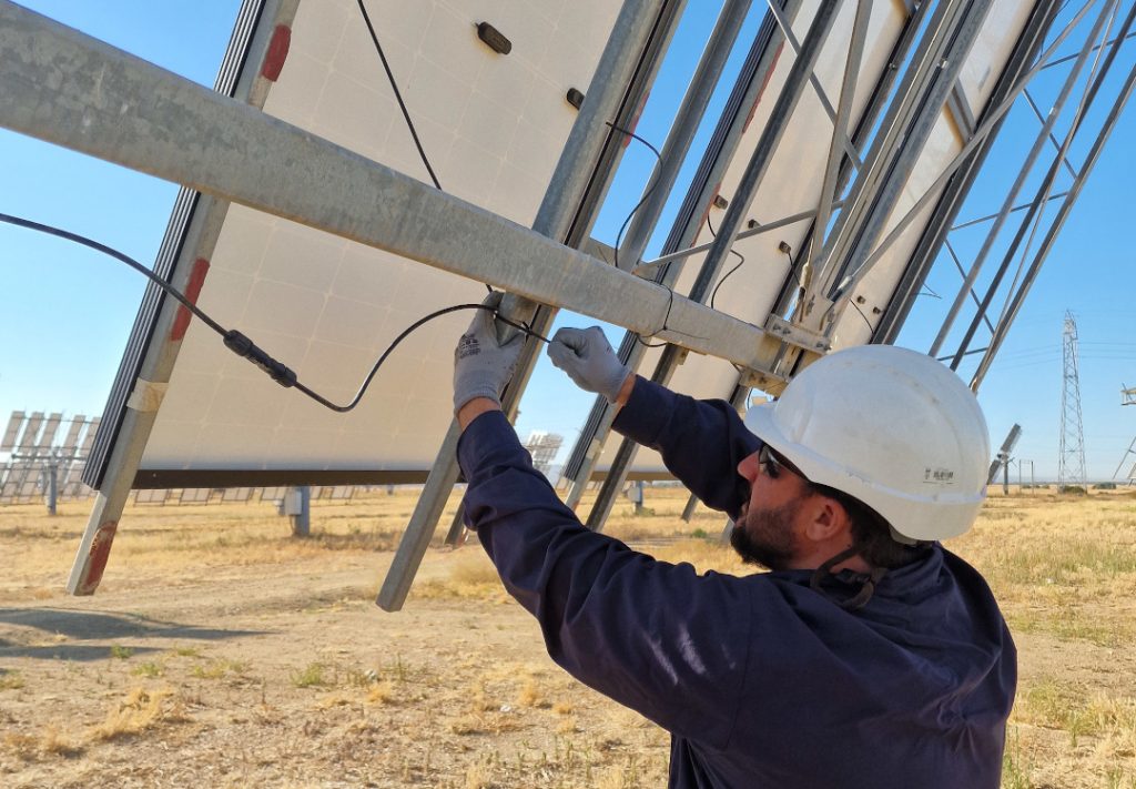

Specialized services for PV plants both in the commissioning phase, warranty period, and commercial operation phase
Among these specialized services, the following stand out:
- Thermographic analysis with drone flight of PV modules, electrical panels, substations, and power lines.
- I-V curve analysis for the performance analysis of modules and strings and their comparison with the manufacturers’ specifications.
- Electroluminescence.
- Module cleaning.

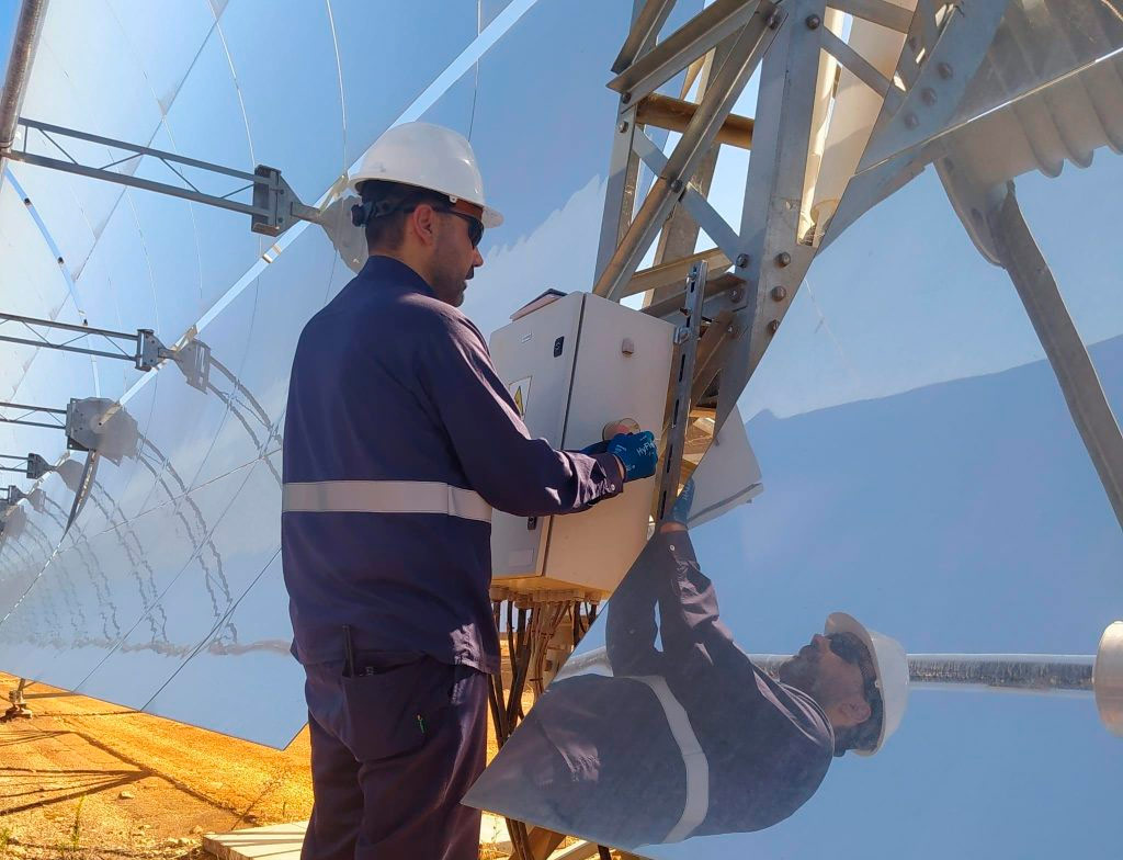

Specialized services for solar thermal plants
- Replacement of mirrors and receiver tubes including loop draining, insulation work, and certified welding.
- Thermographic analysis for solar field characterization including the condition of receiver tubes
- InFRReS® (Injection Feeding Receiver Recovery Services). Argon injection into receiver tubes under technology protected by an exclusive patent license.
- Lifetime analysis of tubes through getter characterization.
