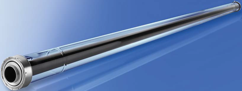

Linear Absorber Tubes or Heat Collecting Elements (HCEs), also simply referred to as Receivers, are used to absorb the concentrated sunlight from the Parabolic Trough [insert link to page with information about PT] collector or the Compact Linear Fresnel [insert link to page with information about CLFR]collector, and transfer the energy absorbed into a Heat Transfer Fluid (HFT) that is pumped through the HCEs. This energy in the form of heat, will elsewhere be used or converted into electricity. Rioglass Solar´s product line uses the registered brand name PTR®, which is the abbreviation for Parabolic Trough Receiver. In the picture below you can distinguish the main elements that form the HCE. Rioglass Solar offer its PTR® product line in different product variations:
  • Diameter steel tube: PTR® 70, PTR® 80, and PTR® 90 mm
  • Length steel tube: 4.060 mm (PTR® 70 and PTR® 90) and 4.386 mm (PTR® 80)
  • Different max. T: 4G for standard HTF or other generations for high temperature Applications

The Rioglass Solar PTR® receivers, which is an advanced technologically tubular heat collecting element (“HCE”) for Concentrated Solar Power plants (CSP) based on Parabolic Trough technology and uses synthetic thermal oil as heat transfer fluid (HTF).
The Rioglass Solar PTR® is the 4th generation of receivers that has been developed based on more than 15 years of proven track record of developing HCEs for the solar thermal industry by Schott Solar and Rioglass Solar
The PTR® receivers are built and tested for extreme environmental conditions and complies with strict standards and quality for Power Piping as well as for Boiler & Pressure vessel (e.g.: ASME B31.1, ASME VIII)
